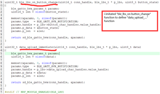

I'm in trouble in solving a question when i learned NRF52832 recentlly.(SD s132, V5.0, SDK15.0)

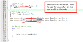

I want to read the temperature data from the sensor on-chip and send it to my phone by bluetooth.

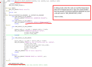

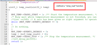

But once the code ran to "temp_read" function, the code would ran to "__WEAK void app_error_fault_handler(uint32_t id, uint32_t pc, uint32_t info)",and then got stuck in
"NRF_BREAKPOINT_COND".
What interesting is, everything was ok when i annotated the code which related to "temperature".So i wonder if  i forgot to set  something so that there're some conflicts between softdevice and "temperature_read" moudle?
