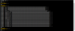

    This is the certificate stored in the "normal" DK and trace. It can connect to tls normally.trace-2021-05-12T01-59-10.472Z.bin
    *** Booting Zephyr OS build v2.4.99-ncs1  ***
    The AT host sample started
    AT+CGMR
    mfw_nrf9160_1.3.0
    OK
    AT%CMNG=1
    %CMNG: 0,3,"0303030303030303030303030303030303030303030303030303030303030303"
    %CMNG: 0,4,"0404040404040404040404040404040404040404040404040404040404040404"
    %CMNG: 0,6,"0606060606060606060606060606060606060606060606060606060606060606"
    %CMNG: 6123,4,"0404040404040404040404040404040404040404040404040404040404040404"
    %CMNG: 16842753,0,"0000000000000000000000000000000000000000000000000000000000000000"
    %CMNG: 16842753,1,"0101010101010101010101010101010101010101010101010101010101010101"
    %CMNG: 16842753,2,"0202020202020202020202020202020202020202020202020202020202020202"
    %CMNG: 16842754,0,"0000000000000000000000000000000000000000000000000000000000000000"
    %CMNG: 16842754,1,"0101010101010101010101010101010101010101010101010101010101010101"
    %CMNG: 16842754,2,"0202020202020202020202020202020202020202020202020202020202020202"
    %CMNG: 35724859,3,"0303030303030303030303030303030303030303030303030303030303030303"
    %CMNG: 35724859,4,"0404040404040404040404040404040404040404040404040404040404040404"
    %CMNG: 35724861,3,"0303030303030303030303030303030303030303030303030303030303030303"
    %CMNG: 35724861,4,"0404040404040404040404040404040404040404040404040404040404040404"
    %CMNG: 35724862,3,"0303030303030303030303030303030303030303030303030303030303030303"
    %CMNG: 35724862,4,"0404040404040404040404040404040404040404040404040404040404040404"
    %CMNG: 4294967293,10,"0A0A0A0A0A0A0A0A0A0A0A0A0A0A0A0A0A0A0A0A0A0A0A0A0A0A0A0A0A0A0A0A"
    %CMNG: 4294967292,11,"0B0B0B0B0B0B0B0B0B0B0B0B0B0B0B0B0B0B0B0B0B0B0B0B0B0B0B0B0B0B0B0B"
    OK
    AT%CMNG=1,1
    OK
