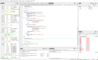

The program hangs while executing the example code.
I am confirming ADC sampling 420Hz operation by following question.
https://devzone.nordicsemi.com/f/nordic-q-a/69096/1khz-or-more-adc-sampling-rate-over-ble
The source code is as follows.

What mistake did I make?
    This is actually as intendend in the original example. The sample application is configured to enter System OFF mode (i.e. deep sleep) from the BLE_ADV_EVT_IDLE event after the advertising has timed out. The only problem that is that the chip can't enter System OFF mode while it's in debug mode, and this is why the program ends up in the error handler if you let advertising time out while debugging.
    If you want, you can disable advertising timeout by setting APP_ADV_DURATION to '0' and replace the BLE_GAP_ADV_FLAGS_LE_ONLY_LIMITED_DISC_MODE flag in advertising_init() with 'BLE_GAP_ADV_FLAGS_LE_ONLY_GENERAL_DISC_MODE'
