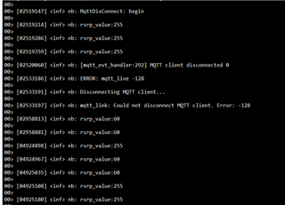

How do I disconnect the MQTT correctly?
I tested NB-IoT and MQTT in NRF9160, and the device could normally search for NB signals and connect to our background through MQTT protocol. After the device uploaded data to the background successfully, I wanted to disconnect the MQTT connection, but MQTT returned -128 to me, why?And even then, I can reconnect to MQTT again, but I can't accept the RSRP signal value any more!
my prj.conf file is like this:

/**@brief MQTT client event handler
static void mqtt_evt_handler(struct mqtt_client *const c,
		      const struct mqtt_evt *evt)
	int err;
	switch(evt->type)
	case MQTT_EVT_CONNACK:
		if(evt->result != 0)
			LOG_INF("MQTT connect failed %d\n", evt->result);
		mqtt_connected = true;
		LOG_INF("[%s:%d] MQTT client connected!\n", __func__, __LINE__);
		subscribe();
		NbSendDateStart();
		MqttDicConnectStart();
		//k_delayed_work_submit_to_queue(app_work_q, &mqtt_send_work, K_SECONDS(5));
	case MQTT_EVT_DISCONNECT:
		LOG_INF("[%s:%d] MQTT client disconnected %d\n", __func__, __LINE__, evt->result);
		mqtt_connected = false;
		NbSendDateStop();
		MqttDicConnectStop();
	case MQTT_EVT_PUBLISH:
			const struct mqtt_publish_param *p = &evt->param.publish;
			LOG_INF("[%s:%d] MQTT PUBLISH result=%d len=%d\n", __func__, __LINE__, evt->result, p->message.payload.len);
			err = publish_get_payload(c, p->message.payload.len);
			if(err >= 0)
				data_print("Received: ", payload_buf,
				/* Echo back received data */
				//data_publish(&client, MQTT_QOS_1_AT_LEAST_ONCE,
				//	payload_buf, p->message.payload.len);
			else
				LOG_INF("mqtt_read_publish_payload: Failed! %d\n", err);
				LOG_INF("Disconnecting MQTT client...\n");
				err = mqtt_disconnect(c);
				if(err)
					LOG_INF("Could not disconnect: %d\n", err);
				#ifdef SHOW_LOG_IN_SCREEN
					sprintf(tmpbuf, "Could not disconnect: %d", err);
					show_infor(tmpbuf);
	case MQTT_EVT_PUBACK:
			LOG_INF("MQTT PUBACK error %d\n", evt->result);
		LOG_INF("[%s:%d] PUBACK packet id: %u\n", __func__, __LINE__,
				evt->param.puback.message_id);
	case MQTT_EVT_SUBACK:
			LOG_INF("MQTT SUBACK error %d\n", evt->result);
		LOG_INF("[%s:%d] SUBACK packet id: %u\n", __func__, __LINE__,
				evt->param.suback.message_id);
	default:
		LOG_INF("[%s:%d] default: %d\n", __func__, __LINE__,
				evt->type);

static void mqtt_link(struct k_work_q *work_q)
	int err,i=0;
	client_init(&client);
	err = mqtt_connect(&client);
	if(err != 0)
		LOG_INF("ERROR: mqtt_connect %d\n", err);
		return;
	err = fds_init(&client);
	if(err != 0)
		LOG_INF("ERROR: fds_init %d\n", err);
		return;
	while(1)
		err = poll(&fds, 1, mqtt_keepalive_time_left(&client));
		if(err < 0)
			LOG_INF("ERROR: poll %d\n", errno);
		err = mqtt_live(&client);
		if((err != 0) && (err != -EAGAIN))
			LOG_INF("ERROR: mqtt_live %d\n", err);
		if((fds.revents & POLLIN) == POLLIN)
			err = mqtt_input(&client);
			if(err != 0)
				LOG_INF("ERROR: mqtt_input %d\n", err);
		if((fds.revents & POLLERR) == POLLERR)
			LOG_INF("POLLERR\n");
		if((fds.revents & POLLNVAL) == POLLNVAL)
			LOG_INF("POLLNVAL\n");
		//k_sleep(K_MSEC(5000));
	err = mqtt_disconnect(&client);
	if(err)
		LOG_INF("%s: Could not disconnect MQTT client. Error: %d\n", __func__, err);
static void MqttDisConnect(void)
	int err;
	LOG_INF("%s: begin\n", __func__);
	if(err)
		LOG_INF("[%s]: Could not disconnect MQTT client. Error: %d\n", __func__, err);
	//err = mqtt_live(&client);
	//if(err != 0)
	//	LOG_INF("[%s]: ERROR: mqtt_live %d\n", err);
static void MqttDisConnectCallBack(struct k_timer *timer_id)
	mqtt_disconnect_flag = true;
static void MqttDicConnectStart(void)
	k_timer_start(&mqtt_disconnect_timer, K_SECONDS(MQTT_CONNECTED_KEEP_TIME), NULL);
