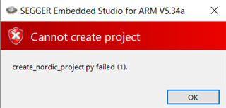

I am tryng to get the nrf9160 and the nrf 52840 to communicate through uart on the nrf9160-dk. I am following this post for that: https://devzone.nordicsemi.com/f/nordic-q-a/58034/uart-communication-between-nrf52840-and-nrf9160-on-nrf9160-dk/235304#235304.

The problem appears in CONFIG_UART_2_NRF_UARTE, if deleted the project is created successfully but when incluiding it, the following error appears:
After that in the SES Output log appears the following:

error: UART_2_NRF_UARTE (defined at drivers/serial/Kconfig.nrfx:175) is assigned in a configuration
file, but is not directly user-configurable (has no prompt). It gets its value indirectly from other
symbols. See docs.zephyrproject.org/.../CONFIG_UART_2_NRF_UARTE.html
and/or look up UART_2_NRF_UARTE in the menuconfig/guiconfig interface. The Application Development
Primer, Setting Configuration Values, and Kconfig - Tips and Best Practices sections of the manual
might be helpful too.
CMake Error at C:/Users/mbasi/ncs/v1.5.0/zephyr/cmake/kconfig.cmake:262 (message):
C:/Users/mbasi/ncs/v1.5.0/zephyr/cmake/app/boilerplate.cmake:534 (include)
C:/Users/mbasi/ncs/v1.5.0/zephyr/share/zephyr-package/cmake/ZephyrConfig.cmake:24 (include)
C:/Users/mbasi/ncs/v1.5.0/zephyr/share/zephyr-package/cmake/ZephyrConfig.cmake:40 (include_boilerplate)
CMakeLists.txt:3 (find_package)
error: cmake failed
create_nordic_project.py failed (1)
Any guess on how can I fix this or what is the problem?
