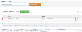

I am trying to run example with NRF91 DK MQTT simple and I am able to connect with LTE network. as shown in below screenshot.
But as shown in the screen shot i am not able to connect to server and it keeps retrying. Please do let me know where i can go wrong.
THnak you.

  • Thank you for providing this information.
    Have a look at a similar case here. Please verify that you network supports TCP over NB-IoT. Have you tried to connect another MQTT broker, e.g. https://www.hivemq.com/public-mqtt-broker/
    Broker: broker.hivemq.com
    TCP Port: 1883
    Øyvind
  • Wohh!!! You are awesome!!! by following above similar case link, we are able to move ahead in our journey. Thank you so much for this. we are able to connect to test.mqtt.org and able to publish and subscriber data to and from mqttFX.
    Now the case is i am getting error while connecting to other brokers as provide by you https://www.hivemq.com/public-mqtt-broker/   so to confirm i have checked it with DNS loopkup and got below results
    By this results i am assuming that this broker is also not IPV6. Just to verify can you provide any other broker which supports IPV6 and we can get the testing done on it for now.
    Thank you.
  • Good to here.
    The https://test.mosquitto.org/ broker should support IPv6. Let me know how that works for you.
    Øyvind
  • Yes as mentioned above test.mosquitto.org works very well no problem at all, we just need one more alternative broker other than test.mosquitto.org to verify after changing broker the code works or not.
    Please let us know if any other alternative you can suggest just for testing other wise it is working with test.mosquitto.org.
    also let me know if you have any link by following i can create IPV6 broker.
