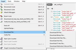

This is not the correct way to program the firmware. You should program sniffer_nrf52dk_nrf52832_7cc811f.hex into the chip through JLink. You have two options:
1. Program with SEGGER EMBEDDED STUIOD
nrfjprog -f nrf52 --program HEXFILE_PATH --sectorerase
nrfjprog -f nrf52 --reset
You can find more information about nRF52-DK from this page.
