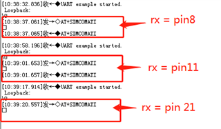

        According to your suggest, I verify this on nRF52840DK (SDK17.0.2) this via serial tool, and the result is:
    1、the default configure:TX=PIN6, RX=PIN8 , result is OK;
    2、custom configure:TX=PIN6, RX=PIN11, result is OK;
    3、custom configure:TX=PIN6, RX=PIN21, result is FAIL;
    The follow is all my changed place :

    and the test log is:
    Can you test on your environment and verify? why the pin21 can not used as the liburate RX?
    Thanks very much and look forward to your reply.
