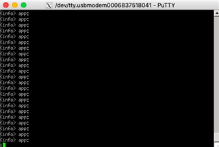

I'm stuck on how to initialise the accelerometer to be able to read the X, Y and Z values for it. When I build, connect J-Link, download the project and launch the program using Putty, the code outputs "Read Fail" which I implemented in the code below, instead of the X, Y and Z values.

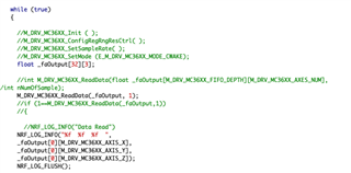

I've included my project's main c file below:

    while (true)
      //M_DRV_MC36XX_Init ( );
      //M_DRV_MC36XX_ConfigRegRngResCtrl( );
      //M_DRV_MC36XX_SetSampleRate( );
      M_DRV_MC36XX_SetMode (E_M_DRV_MC36XX_MODE_CWAKE);
      float _faOutput[1][M_DRV_MC36XX_AXES_NUM];
      int M_DRV_MC36XX_ReadData(float _faOutput[M_DRV_MC36XX_FIFO_DEPTH][M_DRV_MC36XX_AXES_NUM],
int nNumOfSample);
      M_DRV_MC36XX_ReadData (&_faOutput[0][0], 1);
      if (1==M_DRV_MC36XX_ReadData(_faOutput,1))
        NRF_LOG_INFO("%f  %f  %f  ",
        _faOutput[0][M_DRV_MC36XX_AXIS_X],
        _faOutput[0][M_DRV_MC36XX_AXIS_Y],
        _faOutput[0][M_DRV_MC36XX_AXIS_Z]);
        NRF_LOG_FLUSH();
    else{
        NRF_LOG_INFO("Read Fail");
        NRF_LOG_FLUSH();
