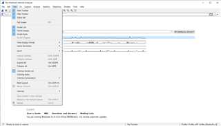

I have referenced the following document.
https://www.nordicsemi.com/-/media/DocLib/Other/User_Guides/nRFSnifferUGv22.pdf?la=en
I checked the contents up to 2.3.
However, I can't see the contents of 2.3.1.
What did I do wrong?

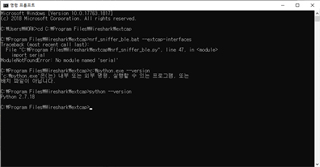

It doesn't work even though I tried running the problem in Trouble Shooting 6.1.
I solved it with the following:
Install Python 39
Enter the following command
