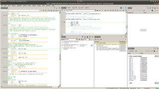

    The following is the call stack, am not sure if the resolution of this picture is ok

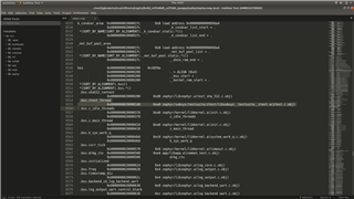

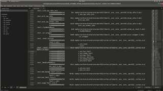

    In addition you could search for 200002d8 in the <project_root>/build/zephyr/zephyr.map file and see which thread that is the culprit. This way you could check the program counter (PC) as well.
    Carl Richard
  • Hi Carl,
    I tried running it without the debugger as well, the result is the same.
    The PC is at the fault handler (fault_s)
    And hex 200002d8 is in ztest_thread in ztest.c itself
