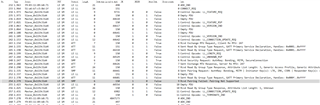

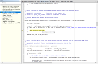

Error 8 occurred when calling sd_ble_gap_conn_param_update when disconnected
The customer requested that pairing be prohibited under certain circumstances, so I called API
sd_ble_gap_sec_params_reply(m_conn_handle, BLE_GAP_SEC_STATUS_PAIRING_NOT_SUPP, NULL, NULL);
under BLE_GAP_EVT_SEC_PARAMS_REQUEST event to reject the pairing request.
After that, I will receive the BLE_GAP_EVT_AUTH_STATUS event, and I get that the encrypted connection cannot be established, so I call disconnect, such as the following code
case BLE_GAP_EVT_AUTH_STATUS:
    if(p_ble_evt->evt.gap_evt.params.auth_status.auth_status == BLE_GAP_SEC_STATUS_SUCCESS)
        NRF_LOG_INFO("pair success\r\n");
    else
        sd_ble_gap_disconnect(p_ble_evt->evt.gap_evt.conn_handle, BLE_HCI_REMOTE_USER_TERMINATED_CONNECTION);
I have four mobile phones, three of which can be disconnected normally, but one of the Samsung Galaxy N10 phones will have problems in the following places. Does anyone know how I can solve this problem?

    Error code 8 is NRF_ERROR_INVALID_STATE, and that is expected as sd_ble_gap_conn_param_update() is called for a connection that is not active. There could be a bug in some library, or in your application causing a race condition.
    Normally, when there is a disconnect, the app timer that will request connection parameter updates will be stopped, as you can see from the implementation in ble_conn_params.c. If this does not happen for some reason and the SoftDevice call is made for an invalid connection, it will return NRF_ERROR_INVALID_STATE. How do you process SoftDevice interrupts? Specifically, what is the value of NRF_SDH_DISPATCH_MODEL in your sdk_config.h? And what is the value of APP_TIMER_CONFIG_IRQ_PRIORITY?

    According to your reply, you mean that the update_timeout_handler event should not appear after the sd_ble_gap_disconnect call?

    NRF_SDH_DISPATCH_MODEL 0
    APP_TIMER_CONFIG_IRQ_PRIORITY 6
    In fact, I found that as long as you call
    sd_ble_gap_disconnect(m_conn_handle, BLE_HCI_REMOTE_USER_TERMINATED_CONNECTION);
    This problem happens sometimes, but when using this Samsung phone, the problem always happens 100% under the same mode of operation.
