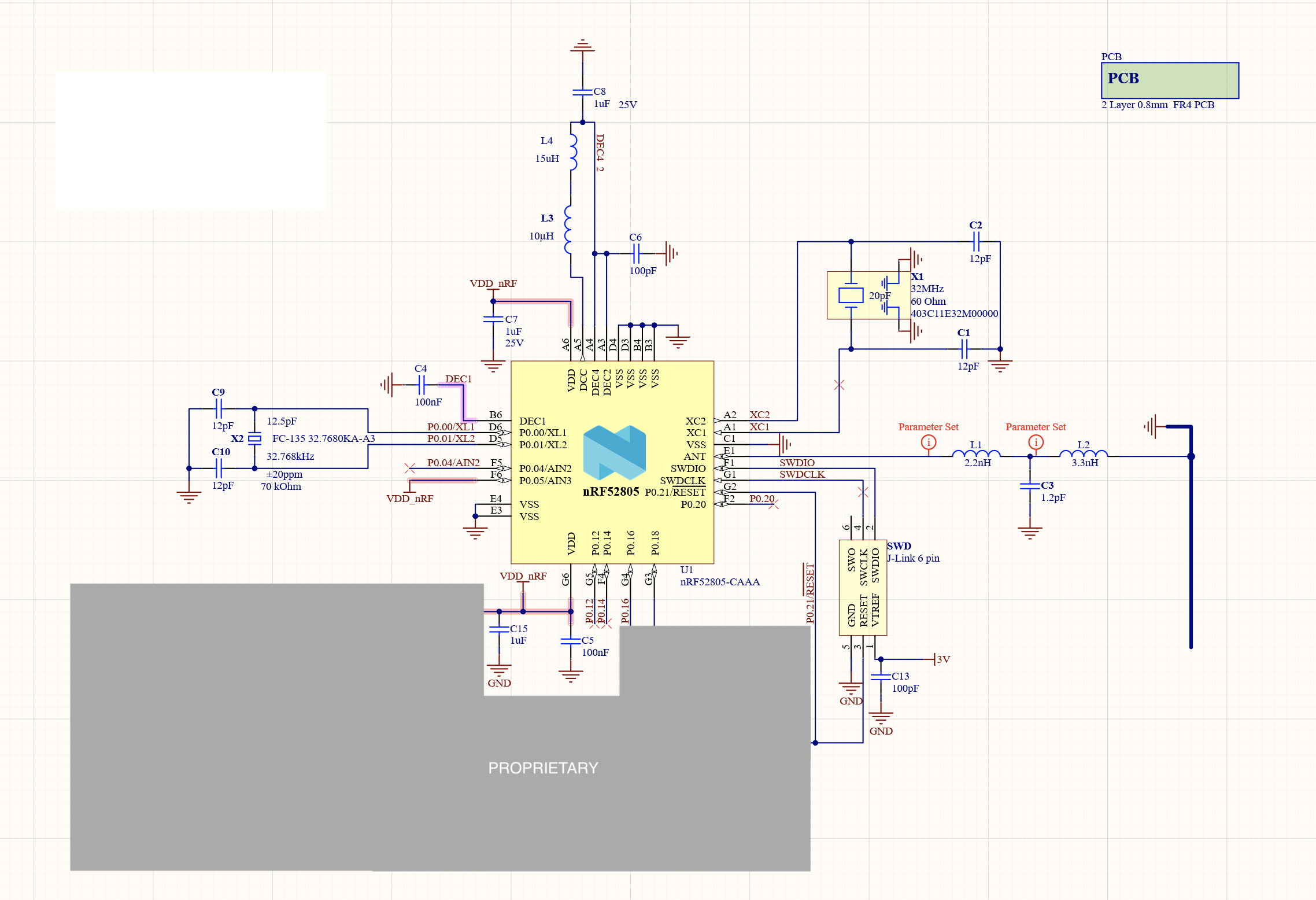

I am looking for some help solving a peculiar issue with eddystone beacons, the nRF52805, and some cheaper Samsung android phones.
System Description:
- I am using a custom board with a nRF52805 (not an OTS module).
- The control I am testing against is another custom board (previous product revision) using an OTS nRF52832 module.
- For both boards, we are using nRF5 SDK v17.0.2 and softdevice 7.2.0 (s112 for the *805 and s132 for the *832)
- I've modified the SDK v17.0.2 to support the nRF52805 using the instructions found in this support article (see "Patching nRF5 SDK v17.0.0 to support the nRF52805" section. The only SDK modifications I've made are the ones from that patch.
- Our firmware project is based off of the eddystone example in sdk/examples/ble_app_eddystone. We arent adhering strictly to the eddystone full packet format, but are at least mantaining the 3 packets (UUID/URL/TLM) with the appropriate service data "headers" - i.e. the frame type. We have some other custom data in the service data, but are otherwise using the cyclic eddystone packet transmission format.
- During "fast" eddystone advertising, we are advertising all 3 packets over a 450ms interval, with 150ms between packets.
- During "slow" eddystone advertising, we are advertising all 3 packets over a 2700ms interval, with 900ms between packets.
- We are not allowing connections, only outgoing advertising packets.
Issue Description:
- For nearly all android phones + using Nordic's nRFConnect app, we are able to see that the nrf52805 and nrf52832 devices are advertising (i.e. packets are detectable and parseable)
- When using the nRF52 DK + wireshark, we are able to see that the nrf52805 and nrf52832 devices are advertising (i.e. packets are detectable and parseable)
- For a small subset of cheaper Samsung phones (e.g. the A10S) using Nordic's nRFConnect App (and our custom application), we are not able to detect advertising only on the nrf52805 boards. That is, while the same Samsung A10S can detect the eddystone packets using identical firmware (Minus the difference in softdevice for *832 and *805) on the *832, it cannot detect advertising packets from the same on *805.
I can't for the life of me figure out what is different between the two hardware versions. For almost all receiving hardware, the packets show up and appear to be functionally identical (except for whats in the service data for each packet after the frame type). I've attached two files showing a Wireshark log of one each UUID/URL/TLM frames (+ packet analysis), but I am unable to determine a difference between the two in any of the packet header/flags/etc.
Does anyone have an idea why some of these cheaper Samsung phones are essentially filtering out the advertising packets from the *805 but not the *832? I realize this is very hardware specific and not necessarily easily reproducible by others.

  • Sorry for late reply,
    X2 is fine, X1 is a bit high, we recommend 12pF as CL. Have you been able to test with those values, 21pF and 36pF?
    matt-lionembedded said:
    Is your recommendation to test the load caps on X1, X2, or both?
    Both, The LF(X2) is used to time when to turn on and of the radio so using a X2 you will have better accuracy on the timing. The HF(X1) is used for the transmitting frequency so if this is off then it also effects the result, but it is the CW that is effects instead of transmitting at the intended frequency there will be a offset. So X1 is probably the culprit in this case.
    Jonathan
