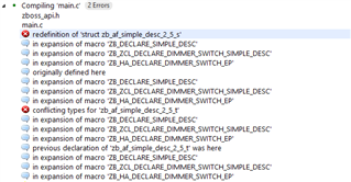

I want to create 2 endpoints on the same zigbee device.
I want to create two switch EP(if it is possible I would like to it as much switches as possible).
I am using WIndows 10 with Segger and nRF COnnect SDK v1.5.0.
I tried it in the following way(I tried other many ways but seems that defining the same macro is conflicting):

I get the following error:

    Ok, I see. So you want to create two endpoints with the light switch. I assume this is because you want to send light switch commands to two separate groups, is that correct?

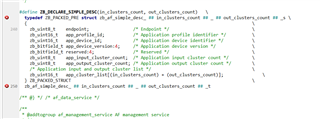

    I see that the compiler error isn't related to the ZBOSS_DECLARE_DEVICE_CTX_2_EP, because it still occurs if I comment it out and use the
    ZBOSS_DECLARE_DEVICE_CTX_1_EP instead. The issue is that you are using two calls to ZB_HA_DECLARE_DIMMER_SWITCH_EP(). Inside this, it uses:
    ZB_ZCL_DECLARE_DIMMER_SWITCH_SIMPLE_DESC() -> ZB_DECLARE_SIMPLE_DESC(), and the latter doesn't consider any names, only the in_clust_num and the out_clost_num. This means you can't use this two times with two instances of the same number of input and output clusters.
    Can you please try to add the attached file to your project (Just copy it into the "include" folder together with nus_cmd.h and zb_mem_config_custom.h", and add it to main using '#include "zigbee_dimmable_light_switch.h" '.
    Then replace the calls to ZB_HA_DECLARE_DIMMER_SWITCH_EP() with ZB_ZCL_DECLARE_DIMMER_SWITCH_EP() in your main.c file. In my case, that made it compile, at least.
