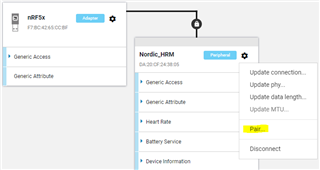

  • I was indeed testing with nRF Connec. I see that I can able a bond from nRF Connect, but how can I initiaite pairing without bonding ?
    On the peripheral, I have configured pm_sec_params_set with the "Pairing, no bonding" configuration (from https://infocenter.nordicsemi.com/index.jsp?topic=%2Fsdk_nrf5_v17.0.2%2Flib_pm_usage.html&cp=7_1_3_2_7_2)
    But I don't see any sdk examples using these parameters. Do you have an example application that is not provided with the SDK ?
    The goal is to use my central device which is a NRF52832. From there, how can I initiate pairing without bonding ? What example can I look at ?
    Click the settings button for the device in nRF Connect for Desktop, select "Pair". Then, click "Pair". Wait until the pair is established before you continue.
