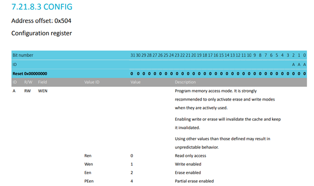

As per nrf5340 product specification document , we can protect the flash erase and flash write operations using write protection.
CONFIG is a register in NVMC . we can set read only access when set 0 in CONFIG register
NRF_NVMC->CONFIG = 0; // read only access
but, I am able to erase the flash and write the flash. It should not happen.

    Also note that the while the CONFIG register of the NVMC can be used to enable or disable flash operations, it can be changed at any time. There are other mechanisms that can be used to provide more protection, such as ACL. I am not sure what your use case and requirements is, though.

    Regarding flash_write_protection_set() that is implemented by flash_nrf_write_protection() zephyr\drivers\flash\soc_flash_nrf.c, and the implementation is empty. So that is not functional. I have not been able to clarify why that is yet.
    Regarding writing to the register directly that should work. But note that NRF_NVMC is only relevant for the network core, for the application core you have NRF_NVMC_NS and NRF_NVMC_S.
    Also, you you may memory barriers before writing immediately after, so something like this:
    NRF_NVMC->CONFIG = NVMC_CONFIG_WEN_Wen; // or NVMC_CONFIG_WEN_Ren or NVMC_CONFIG_WEN_Een
    __DSB();
    __ISB();

    I missed an important point before. You are using the flash_erase() function, which is implemented for the nRF in soc_flash_nrf.c. Referring to NCS 1.5.1 you can start at line 268, where you see flash_nrf_api.erase (which is called when you call flash_erase()) is implemented by flash_nrf_erase(). If you follow that further down via some intermediate calls you end up with nrfx_nvmc_page_erase() which is implemented in nrfx_nvmc.c. That calls nvmc_erase_mode_set() which writes to the NVMC_CONFIG registers (both secure and non-secure variants). So in short, it does not matter if you set it before, it will be overwritten by this call.
