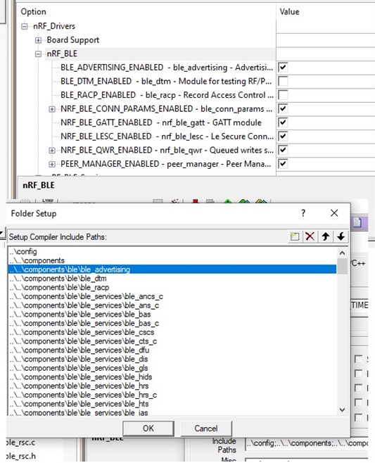

    The BLE_ADVERTISING_DEF is defined at ble_advertising.h. Can you help me check again that: the ble_advertising.h is included your project? If not please add this library and in sdk_config.h file, please certainly the BLE_ADVERTISING_ENABLED sets 1.
  • I double checked it and the library is included and BLE_ADVERTISING_ENABLED is properly enabled.
