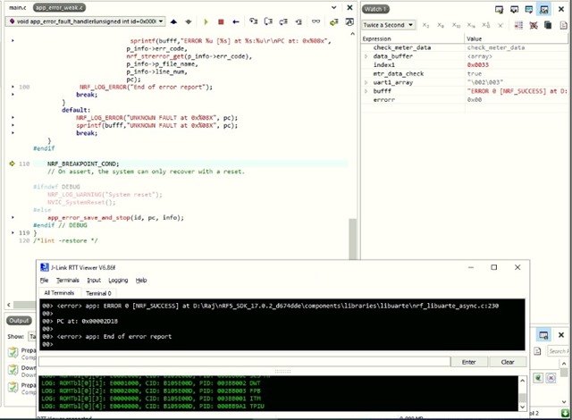

Hi there,
I'm using nrf52840 DK and Custom board, SDK 17.0.2, Segger Embedded Studio(SES v5.20
my problem was the code running fine but after a while it will go to the app_error_weak.c file and stop to  NRF_BREAKPOINT_COND; line.
i don't understand what is going on please help me out for this.

       if(cnt<3)
      goto SET3;
      cnt++;
  }//while
}//main
uint8_t send_meter(uint8_t * ip_array, uint8_t len, int timeout)
  memset(uart1_array, 0, sizeof(uart1_array));
  index1 = 0;
  nrf_gpio_pin_write(RS485_RE, 0);
  nrf_gpio_pin_write(RS485_DE, 1);  //for sending (1/0-HIGH/LOW)
  nrf_delay_ms(1);
  for (uint8_t i = 0; i < len; i++)
    NRF_LOG_INFO("%X", ip_array[i]);
  sendSerial(ip_array, len);
//  nrf_delay_ms(1000);
  nrf_gpio_pin_write(RS485_DE, 0);  //for sending (1/0-HIGH/LOW)
  nrf_delay_ms(1);
  while (timeout--)
    if (check_meter_data())
      nrf_delay_ms(1);
      return 1;
    nrf_delay_ms(1);
  }//while
  nrf_delay_ms(1);
  int k = 0;
  return 0;
}//send_meter
thank you for advance.
