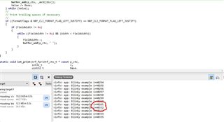

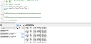

    Im copy your project into \examples\ble_peripheral directory and erase all from board(nrfjprog --eraseall) then build and Debug it
    After Build Im press "continue execution" and app is started and debugger inside SEGGER Studio start writing lines. Then after few seconds Im press break and check lines inside log. They are normaly inserted but I think a lot of slower that in my example. Im check and you use SEGGER_RTT_CONFIG_DEFAULT_MODE 2 which block logging if buffer is full and also app stop responding if RTT is not connected because LOG function when buffer is full block executing code...
    This is your example:
    If I only change in your example SEGGER_RTT_CONFIG_DEFAULT_MODE back to 0 I can reproduce my problem:
    I think that here is problem with NRF_LOG_FLUSH() function which do not block and flush logs from buffer when you call it and probably do this asynchronous ...
  • I think you may expect a bit too much from the logging module.
    I just took your project and changed deferred to 0.
    As you see from the description of SEGGER_RTT_CONFIG_DEFAULT_MODE in sdk_config.h when set to 2 all NRF_LOG_INFO/DEBUG/... calls are blocking, meaning they will be blocked until the log buffer has room for that log message. When it is set to 0, it will skip all messages that doesn't fit. This is why you see the gaps.
    Another note:
    You can use NRF_LOG_FLUSH() in your main loop, but you can't use this wherever you want. Basically, if a call to NRF_LOG_FLUSH() is interrupted by another call to NRF_LOG_FLUSH(), then the device will crash, so keep this in your main function (and you can use it in error handlers that will reset after calling this, like it is done in the error handler).
