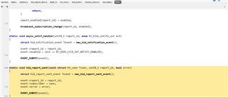

Can Mouse event report rate be adjusted dynamically? If yes,how can we do it?

Hi Frank, You can adjust the report rate by : 1. Adjust connection interval. or 2.Add a delay mechanism to put off the hid_report_sent_event in hid_report_sent function in hid.c.
