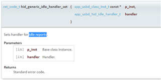

Hi Team
I read the usbd_hid_generic in nRF SDK 16.0.0. The function hid_generic_idle_handler_set set a handler for idle reports. What is the idle reports mean? where descript it in USB spec? Thank you.
Regards
Victor
Hi Team
Regards
Victor
This is to handle the "SET IDLE" (SET_IDLE) HID-specific command:
https://www.usb.org/sites/default/files/hid1_11.pdf
Kenneth
