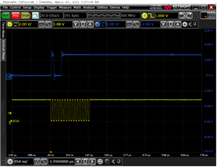

Currently I am working on SPI communication with LSM6DSOXTR.
CLK, MOSI, SS is working as expected. But there is no MISO signal.

2) WHO AM I register is 0x0FU.
It becomes 0x8F(MSB to 1: read). And It sent to MOSI.
And 16 bit clock is created correctly.
    Read function is updated. Now WHO_AM_I is read correctly.
    But It seems like write function doesn't work correctly.
    I wonder why delay should be done between each 8 bit in read function?
    And how could I fix write function?

  • What is the context in which you are calling lsm_read? probably the answer to that question might give some hints as to why replacing __WFE with busy delay helps in your case. I have not seen into the timing requirement of your sensor.
    5us delay does not look bad in a lower priority threads, so if it works, keep it.
