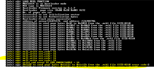

  • Hi Jorgen,
    I migrated from code nrfx_twi to nrfx_twim successfully.
    I want to write 28 pages  (28 x 8210bytes) 1 page at a time.
    for the same, I have made 28 static buffers in the code containing 8210 bytes in a sequence.
    Now with your suggestions, I have written 13 pages successfully out of 28 but as soon as it tries to write the 14th page the function returns error code 16.
    what error code 16 refers to?
    how do I resolve it?
    Thank you
    -Gaurav
    Error code 16 means NRF_ERROR_INVALID_ADDR. If you are declaring 28 static buffers containing 8210 bytes, this will consume 224kB of RAM, which is almost the full RAM size of the nRF52840 (256kB).
    From the API documentation for nrfx_twim_tx, you can see the reason for this error code:
    NRFX_ERROR_INVALID_ADDR The provided buffer is not placed in the Data RAM region.
    Most likely, the buffers does not fit in RAM and cause some issues. Do you need to declare all buffers at once, or can you re-use the same buffer for more than one transfer? Storing the data in flash initially and copy it to one or a couple buffers while transmitting may be a better approach.
