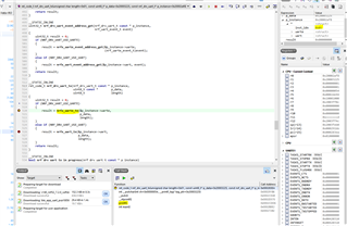

Unfortunately, after these changes the UART that we were previously already using successfully is no longer working.
This is coming into a conditional breakpoint:
    app_uart_comm_params_t const uart1_settings =
        .rx_pin_no    = UART1_TX_PIN,
        .tx_pin_no    = UART1_RX_PIN,
        .use_parity   = false,
        .baud_rate    = UART_BAUDRATE_BAUDRATE_Baud115200
    APP_UART_FIFO_INIT(&uart1_settings,
                       UART_RX_BUF_SIZE,
                       UART_TX_BUF_SIZE,
                       uart1_event_handle,
                       APP_IRQ_PRIORITY_LOWEST,
                       err_code);
    APP_ERROR_CHECK(err_code);       // check if UART is setup without errors
What are we missing?
