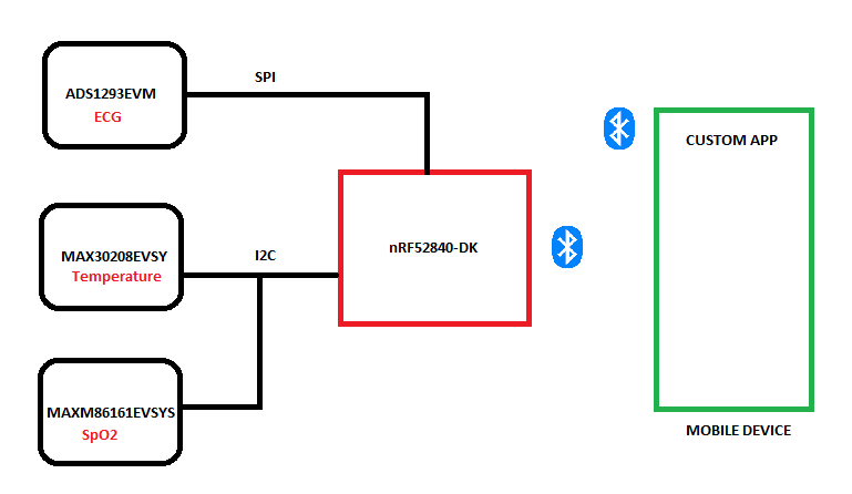

I am writing to ask for info for the first application with BLE.
I need to send data acquired by sensors, RAW mode, via the BLE application to the smartphone APP.
In this regard I have installed Segger Embeded Studio and Nordic SDK v17.0.2 and I have seen that there are many examples made available by Nordic. I have board nRF52840-DK with hw pca10056.
I would like to use the stack present in S140. Which example should I use, as a template, to acquire from my heart rate and temperature sensors and send it(RAW format)  to the smartphone app?

    After the advice received, and thank you, especially at awneil, I have studied and now I have many clearer things about BLE.
    I refer to GAP and GATT role, pre connection and post connection etc. etc. I also saw examples for using NUS,
    I uploaded to my board, I used: C: \ Nordic_Semi \ nRF5_SDK_17.0.2 \ examples \ ble_peripheral \ ble_app_uart I have also modified and now I want to send data, by pressing button 3 of the nRF52840-DK, to the nRF Toolbox UART app.
    Now the question is, where do I set the maximum BLE connection speed and how much I can set the maximum MTU value, now is: NRF_SDH_BLE_GATT_MAX_MTU_SIZE 247
