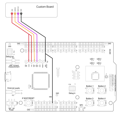

Error programming mbedOS application on custom nRF52 board with nRF52-DK using DAPLINK
The problem is I can't figure out a way to use the shield pins on the board (P20) to program an external MCU (nrf52832). It just refuses to do so it always programs the onboard chip. I even tried shorting SB32 and it didn't work. I am using mbed studio to develop and debug.
Things I tried:
  1. I tried connecting my mcu directly to the SWD trace connected onboard. I soldered to the nets on P18 and then cut power to the onboard MCU from SB9.
My Setup:
Hardware: nrf52-DK Version 2.1.0
Interface MCU firmware: 0253_sam3u2c_mkit_dk_dongle_nrf5x_0x5000.bin
Parents Reply
  • MTomoum said:
    I have indeed tried to use p19 but I used the nrf VDD to power my board instead of an external supply but it didn't work.
    Have you measure what output voltage are you getting from VDD pin on P19?
