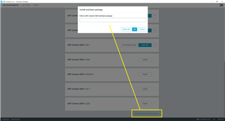

I got the following error when I try to open nordic sample project in SES workbench...May I ask what happened? Thanks
