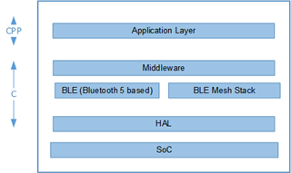

    Actually we needs to have application layer files in CPP. as below.
    So that we planned to have convert model_handler.c to model_handler.cpp.
    But unfortunately we are getting compilation on compiling  the below structure array definitions.
