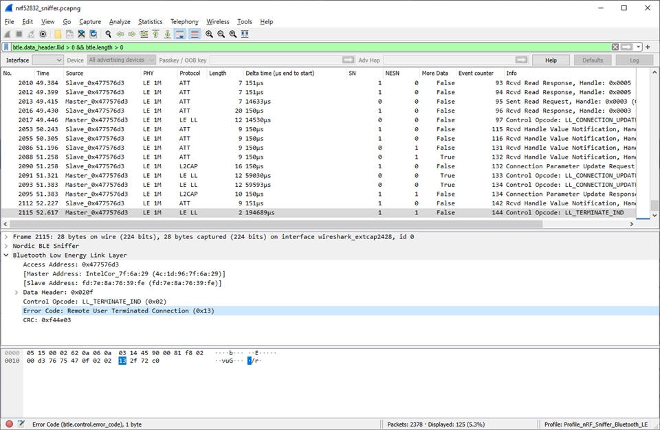

As said above, i've tested two laptops, and this situation happened. I have no idea why this will happen. Is there may any problem with the connection parameters in the code?
(I use SD s132, V6.0, SDK15.0)

An on-air sniffer log would be very useful:
https://www.nordicsemi.com/Software-and-tools/Development-Tools/nRF-Sniffer-for-Bluetooth-LE
https://infocenter.nordicsemi.com/pdf/nRF_Sniffer_BLE_UG_v3.2.pdf (there might be newer depending on when you read this)

OK, but can i know the reason of disconnection by it? how can it help me,
sorry , i just know a little about sniffer, can you tell me what can i get in sniffer log and how to analyze my problem ?some details or examples will be ok.Thanks a lot
Run the sniffer when it fails, upload the log here, then we can analyze.
