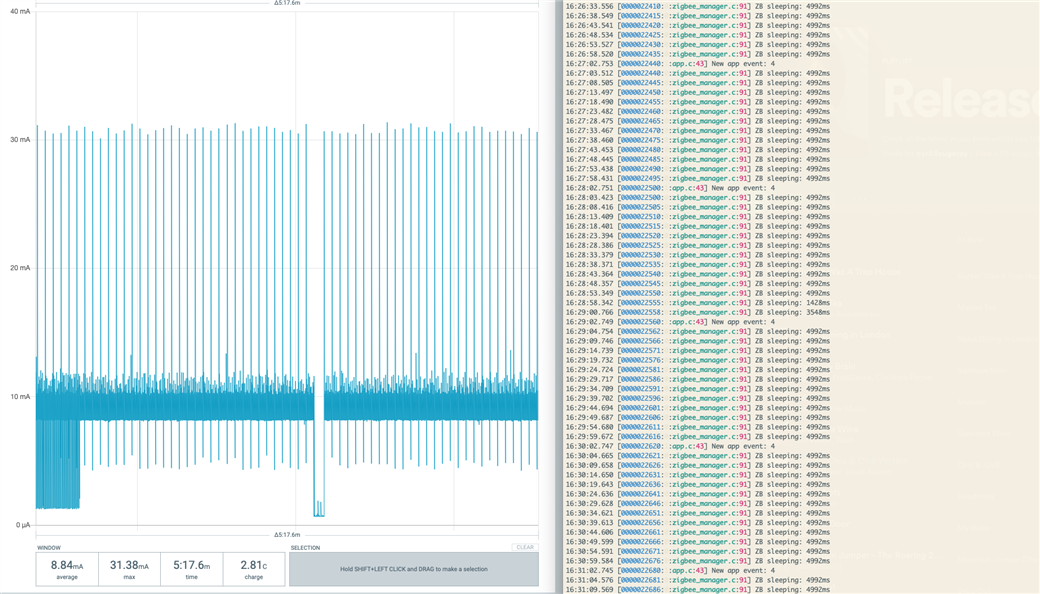

  • Hello
    It's been a while but I still have the issue so here is below the screenshot of the PPK measurements.
    I am setting a polling time of 5 seconds (ZB_MAX_LONG_POLL_INTERVAL_MS 5000)
    Below is the weird behavior I am witnessing: whenever the sleeping time is more than ~4000ms, the RX antenna seems to be left on. (at the beginning, we can see some BLE advertising as well). I am using the UART to print the sleeping time on the right.

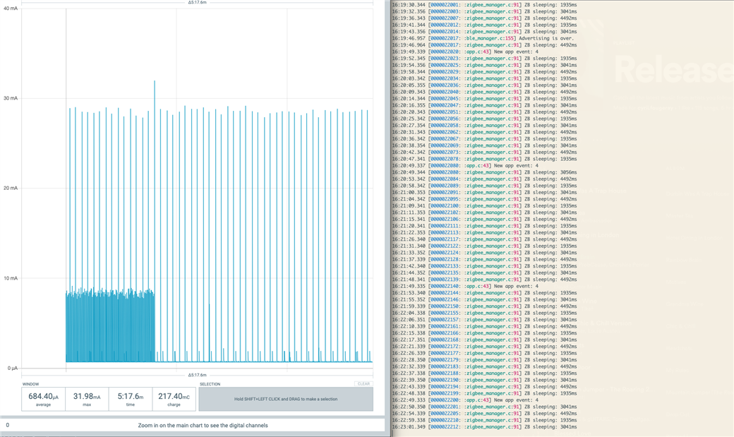

    Then, I apply my dirty fix:

    Below, is the current consumption with the fix:
    Best,
    Cyril
  • while writing the last comment I thought about the returned value as well and changed only that value (not the timer):
    return sleep_tmo-500;
    And it actually works: current consumption is kept low.
    So the question is how do you use that value?
    I hope this will help you solve that issue.
    Best,
  • Actually, removing 1 also works as a workaround.
    return sleep_tmo-1;
    When removing 500 like in my last comment, I can see that the current is a bit higher during 500ms when getting out of sleep.
    I might not have totally understood the goal of that returned value?
