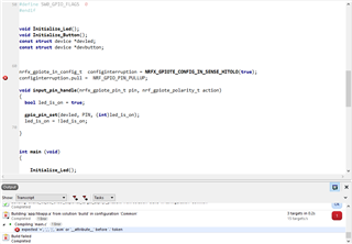

When I build, I have this error :
By the way, I am not sure if
nrfx_gpiote_in_init(SW0_GPIO_PIN, &configinterruption , input_pin_handle);
nrfx_gpiote_in_event_enable(SW0_GPIO_PIN, true);
is a good solution for what I want.
I took example from \ncs\v1.5.1\zephyr\samples\basic\button but what I want to do is : LED off -> Button pressed and released -> LED on -> Button pressed and released -> LED off
Anyone has any suggestion or example of code? I am working on nRF52840 and NCS
