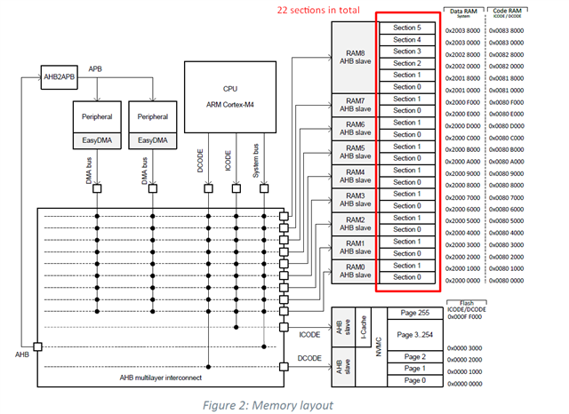

STALLSTAT on SPIM3 writes to flash IC
Our application has a bug that I am trying to track down, but it's being a little tricky.  We are writing a good deal of data to a NAND flash IC over SPIM.  Right now the SPIM is set to 1MHz and we are using SPIM3.  Each write is one page, which is 0x0880 bytes.  Everything is being done by J-Link in SES.
I keep running into STALLSTAT being set for TX when I perform writes.  If I perform a bunch of writes it usually happens around page 0x70.  I can also very reliably get the behavior by performing a read, then a write, then a read while stepping through my code - if I simply step over my read, write, and read functions in that order, I get a TX STALLSTAT every time.  I have this code in a test application I made to just verify that the flash ICs are reading and writing properly.  If I step through the code one line at a time, I get no stall.
I'm not really understanding what is causing this behavior.  In the file transfer I assumed I would find a place where I am writing to the TX buffer before it is emptied.  But in the test application I have a page write buffer that is filled with some nonsense data to write to the flash, then I have a different page read buffer for reading out the data.  When I do the write, I am only pointing the SPIM to the page write buffer, which isn't ever changed.  Because I get a stall, I am led to think that the read that I perform immediately after the write steps on the memory that the DMA is using for the write, but that is in a different location!
Anyway, I'm a little confused, which leads me to believe that I don't entirely understand the bus contention scenarios that can cause stalls.  Is it possible that the debugger itself is somehow involved?
Edit: Here is the code that runs in my test application, it's very minimal.  The flash_mem api is just a wrapper of nrfx_spim_xfer with the commands appropriate to our flash IC.
main.c:

  • Hi
    The STALLSTAT should only occur due to ASHB bus congestions (AHB bus masters trying to access the same AHB slave at the same time). An EasyDMA channel is an AHB master, so apparently it tries to use an already busy peripheral in this case.
    It could be that the UARTE tries using the same bus for logging for example, or that you have another peripheral using it for some reason. So yes, if you use the UART backend for logging, I guess the debugger could be the peripheral conflicting with SPIM. You can try disabling logging altogether to see whether there are more successful writes on your flash.
    Simon
  • And actually, if you'll check the question, I've posted a minimal example that reproduces the behavior, as well as my compiler settings and sdk_config.
  • Try moving the buffer to a reserved SRAM area which no other code accesses, rather than just stuffing it on the stack which is the most memory-intensive SRAM area:
        uint8_t buff[0x0880];
    That way the buffer gets its own DMA AHB slave bus and doesn't have to share. Something like this, there are examples in the devzone:
    // Place following data in section .spim3 so it has private SRAM segment
    #pragma default_variable_attributes = @ ".spim3" // if using IAR
    // Reserved spim3 buffer
    volatile uint8_t buff[0x0880] __attribute__((section(".sect_spim3")));
    #pragma default_variable_attributes =            // if using IAR
    // End - Place following data in section .spim3
    // These are the SRAM areas:
    //  RAM0 Section 0 0x2000 0000 - 0x2000 0FFF
    //       Section 1 0x2000 1000 - 0x2000 1FFF
    //  RAM1 Section 0 0x2000 2000 - 0x2000 2FFF
    //       Section 1 0x2000 3000 - 0x2000 3FFF
    //  RAM2 Section 0 0x2000 4000 - 0x2000 4FFF
    //       Section 1 0x2000 5000 - 0x2000 5FFF
    //  RAM3 Section 0 0x2000 6000 - 0x2000 6FFF
    //       Section 1 0x2000 7000 - 0x2000 7FFF
    //  RAM4 Section 0 0x2000 8000 - 0x2000 8FFF
    //       Section 1 0x2000 9000 - 0x2000 9FFF
    //  RAM5 Section 0 0x2000 A000 - 0x2000 AFFF
    //       Section 1 0x2000 B000 - 0x2000 BFFF
    //  RAM6 Section 0 0x2000 C000 - 0x2000 CFFF
    //       Section 1 0x2000 D000 - 0x2000 DFFF
    //  RAM7 Section 0 0x2000 E000 - 0x2000 EFFF
    //       Section 1 0x2000 F000 - 0x2000 FFFF
    Ensure the section .sect_spim3 is defined in the linker area as a separate SRAM area in SEGGER_Flash.icf file. Here is an example from Torbjorn: designate-one-ram-block-exclusively
    Note also using P1.nn pins is dodgy if you wish to boost to a much higher serial SPI clock, since those pins do not allow H0H1 drive settings, which you will need. Port P0.nn is preferred.
