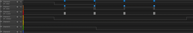

4-byte long SPI messages, "1234", are sent to nRF 52DK. The code in DK is attached below. The XFER_DONE event is created before the message ends, which happens very often. I tried to change message frequency, clock frequency, and lots of things. Nothing is changed.

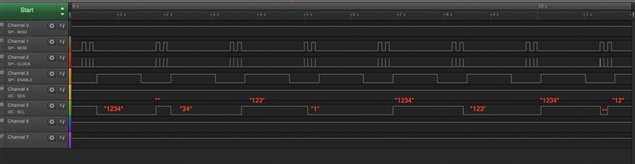

The below figure shows the sent SPI messages containing "1234". The toggled port is on Channel 5 when XFER_DONE is created. The corresponding received messages are shown between asterisk symbols on the figure.
I need more accurate messaging. Any suggestion?
