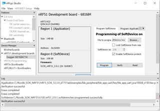

  1. I have set up the soft device s130 before trying to build the target using nrfGo

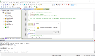

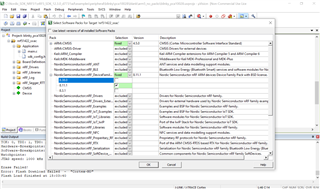

  2. I checked the software packs in Keil and the version from the DeviceFamilyPack I'm using and it shows 8.11. Whenever I try to tick 8.38 the target builds successfully but I get a Download Failed - "Cortex-M0" error when trying to run it:
    Run Error when I tick 8.38.0:
