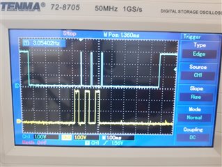

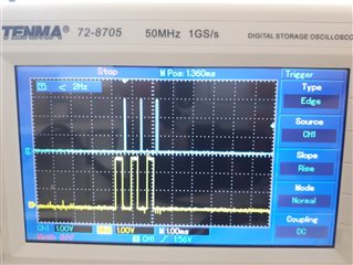

Hello, I am using nRF52840, SDK v16.0, mesh SDK 4.2.0 and softdevice S140 7.0.1. I am following this example to experiment PA/LNA features, namely controlling the pins that enable TX and RX in a front-end radio amplifier.
What happens is that I am able to check pins of port 0 being switched on and switched off automatically by the softdevice, but when I try to use any pin from port 1, it does not work.

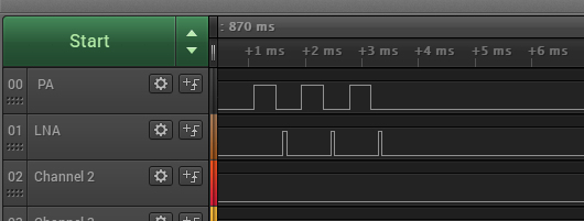

    I did not test this on the mesh, but tested this directly on the softdevice HRS example.
    I tested this on port 0 (pint 30 and 31)
    The below is from P1.01 and P1.03 which also seems to work.
    So this is clearly not the problem with softdevice and it seems like they infact have fixed it.
