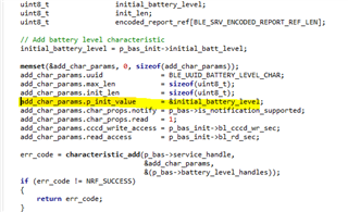

I get read service content retained after reset, and it is read by the central before I get the chance to change it. Please advise how to clear it upon restart.
Daniel
Daniel
Are you specifying an initial value when you initialize this characteristic that is being read by your client? The initial value will always be set after a reset.
E.g.,
Vidar
Vidar, Thanks,
Daniel
