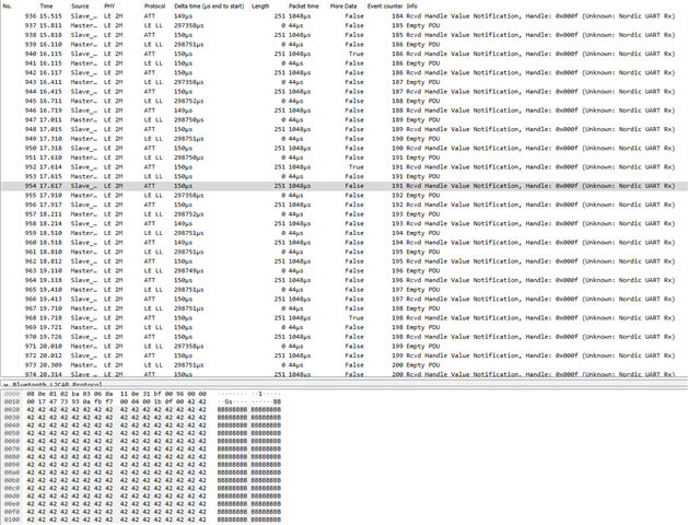

One message per connection interval
As you can see in the picture, the master opens the connection interval with a 44 us (2 M PHY) packet at every ~300.000 us. This is because I had set the interval to 300 ms. There after, the slave answers with a 251-byte packet that takes 1048 us, which is expected. However, the "More Data" column shows "False" which results in the closing of the connection interval.
What could be the problem? Please help me find a solution!

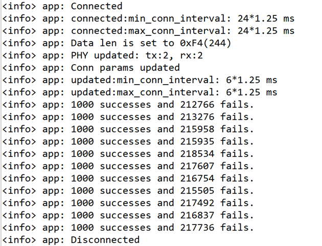

    I have declared two counter variables in the message sending loop, success_cntr and fail_counter. I attempt to send 1000 messages and count number of successes and failures. After 1000 messages, I clear the counters and start over. Here is the log:
    sending fails vs successes

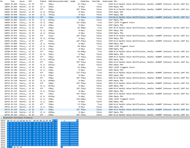

    Some interesting revelations: I have run some test with different application message sizes. My ATT MTU is still 247 but my application is set to send 20 / 128 / 150 / 180 / 200-byte messages. The results show that multiple messages are sent within every connection interval, if the app message size were 20 / 128 / 150. Here is the Sniffer log when the application message contains 150 bytes:
    Sniffer log for 150 byte msg
    You can see that it sends 4-5 messages in every interval.
    When the application messages were 180 bytes or above, I get a sniffer log similar to what I reported earlier, i.e. one message per connection interval. Here is the Sniffer log for 180-byte application messages:
    Sniffer log for 180 byte msg
    Here it shows that mostly only one message gets sent per interval.
