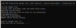

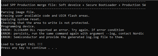

We widely use this MCU on our products.
Last batch with Rev-D has many issues with burn process.
I'm attaching 2 screenshots along with logs of the problems.1st Issue Log.log
2nd Issue Log.log

Is the devices that have failed here always failing to program successfully?
Have you tried reducing the clockspeed? this can be done by adding "-c 1000" to the nrfjprog call.
