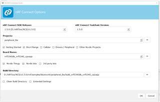

and I have get start the nRF5340DK with nrf_blinky so. I used cpuapp nrf5340dk

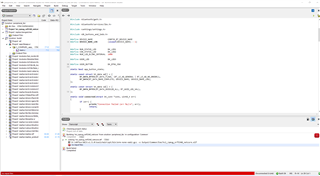

and created the netcore but while download the netcore hex. from SES but showing the error no input file

    According to the "Programming the network sample from SES guide, you should first build an application onto the app core before trying to flash the hci_rpmsg_nrf5340_netcore application onto the network core. Are you able to do that successfully first? It seems like you're mixing these two processes together.

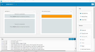

  • Hi Simonr, Yes before flash the netcore. I am able to build the application core successful.. but i can't able to flash the netcore hex file from the segger studio. Instead of doing that i am able to flash the netcore hex file from nrf connect desktop. and after that i am able to flash the application core from the segger studio.
