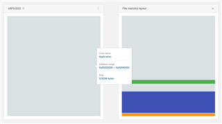

When using nRF Connect and read the contents of the chip it always says "Core0: Non-volatile memory has been read. 1 non-empty memory blocks identified" even after issuing an "Erase All"... this is my first time with this tool so I'm not sure if this is normal or not... Even if I try to flash it with this tool it will not be longer recognized after writing it... needed to do the recover process above.

  • Ok, after some more tests I see that if I flash a simple program like a blink demo the program flashes and device is still recognized. So the porblem appears when I flash a SoftDevice! No matter which one.... why may this happen?
    In case this may help this is how the device is recognized:
    14:19:16.438 Core RAM: 64KiB
    14:19:16.438 Core ROM: 512KiB in pages of 4KiB
    14:19:16.564 Model: NRF52832_xxAA_REV2.
