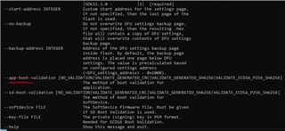

    There is also an option to select no boot validation when you generate the settings page. So another easier option could be to create a settings page to use during development which has boot validation of the application disabled. This settings page can be loaded automatically like we do with the Softdevice.

    is it possible to stop the CRC checking of the soft device using this command?
    Yes, you can generate the setting with the config --sd-boot-validation NO_VALIDATION.

  • If I set  --sd-boot-validation NO_VALIDATION will the softdevice still get CRC checked after a DFU update that includes a softdevice? But once its passed that it won't be checked again?
