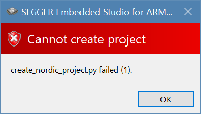

I just used the nRF Connect Toolchain manager to install the NRF Connect SDK. Then, the Segger studio keeps popping this error when I try to open a project:

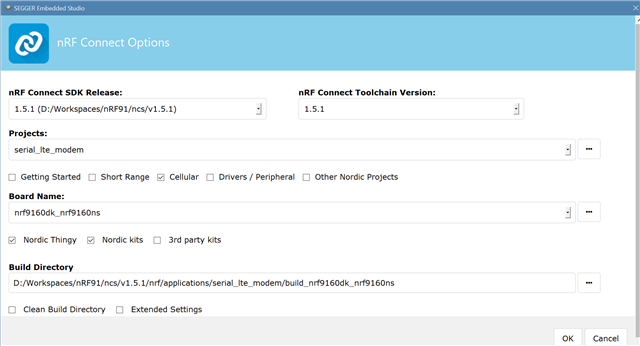

And, here is my configuration for the project.
Is there anything wrong with the configuration? Thanks for the help in advance!

  • BTW here are the outputs from segger:

  • Hi Sam,
    Can you please reinstall your NCS tag in a folder with shorter path e.g. C:\NCS\v1.5.1 We have seen the path length might be an issue.
    Thanks
    Øyvind
  • Thanks, Øyvind. Yes, it's the path length issue.
  • BTW, the "NCS" folder (in C:\NCS\v1.5.1) MUST be put under the root directory of the drive.
    I tried even under one lower level directory (like C:\Workspace\NCS\v1.5.1), it will cause issue during project compilation. This is quite inconvenient.
