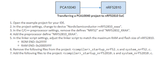

I'm struggling to adjust the BLE_blinky example in the Segger Embedded Studio from the NRF52810 to the NRF52811.
I tried to follow the documentation from here (infocenter.nordicsemi.com/index.jsp

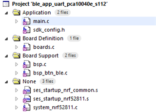

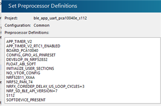

Here are my current settings:
Any suggestions what I'm doing wrong?
