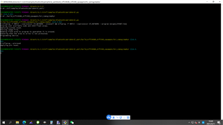

    I changed example as you had told to me . i build solution.use git_cmd,erase cpu net ,in main.c change #define UART_BUF_SIZE 20 into #define UART_BUF_SIZE 70 ,in uart_cb()
    case UART_RX_RDY:
    if (buf->len == 40) {
    build/debug ,go ,from ble of board ,the largest bytes is still 20  that can be send to APP.
    do zephyr\samples\bluetooth\hci_rpmsg\prj.conf have no  effect to cpu_net core of example peripheral_uart ?
    i program the cpu_net core of example peripheral_uart  with \nrf\samples\bluetooth\peripheral_uart\build_nrf5340dk_nrf5340_cpuappns\hci_rpmsg\zephyr\ merged_CPUNET.hex .
    program can run well  and connect with app and not reset.
