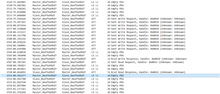

  • Thank you for your answer.
    When I use nRF Sniffer, it seems to be stopped as much as the slave lataency when master -> slave.

    Seems that you are using write request from central to send data to the peripheral.
    This will be affected by Slave Latency, it's because the slave wouldn't know when the central needs to send data and may skip the connection event when the central wants to send data.
    Please note that if you want high throughput it's better to use write without response (write command) instead of write request.
    If you have to send data from central to peripheral, I think the best way to reduce power consumption is to control the connection interval. Meaning when you don't have data to transfer, you can configure the connection interval to a long one, for example once a second. And when you have lots of data to transfer you can configure the connection interval to shorter one, says 20ms.
