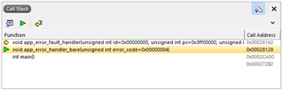

    When I try to add a base uuid 2nd time I getting a app: Fatal error.
    I even changed number of vendor-specific UUID from 0-->2
    #define NRF_SDH_BLE_VS_UUID_COUNT 2
