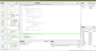

    When I try to add a base uuid 2nd time I getting a app: Fatal error.
    I even changed number of vendor-specific UUID from 0-->2
    #define NRF_SDH_BLE_VS_UUID_COUNT 2
    Please make a debug build (if using SES, then just select the build target "Debug". If using another toolchain, then define "DEBUG" and "DEBUG_NRF" for the project. That way you will easily see in the log in which file, and which line number you got which error code. Which function call returns which error code?
  • Ya I did them and the error is exactly on line where a I add the  2nd CUS BLE Service.
    to be precise sd_ble_uuid_vs_add was returning the error code 4. which is from ble.h line 520.
    // Add the Custom ble Service UUID
    ble_uuid128_t base_uuid1 = CUS_SERVICE_UUID_BAS1;
    err_code = sd_ble_uuid_vs_add(&base_uuid1, &p_cus->uuid_type);
    NRF_LOG_INFO("003 %d", err_code);
    if (err_code != NRF_SUCCESS)
    return err_code;
    And the error code was 0
