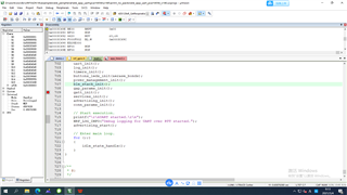

the develop board is PCA10056 with a main CPU nrf52840
Have you ever flash the s140 code to your develop board? It seems like the software device is not exist in your develop board.
first build then flash ,last click debug, flash two times
Check this!
You should flash your SD(software device) first.
how can i first flash my SD(softDevice),please tell me the steps ?
