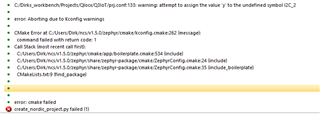

And I have added the following rows to the prj.conf file:
#Configure I2C
CONFIG_I2C=y
CONFIG_I2C_NRFX=y
CONFIG_I2C_2=y
When I try to open the project I get however an error:
I am using nRF SDK v1.5.0
Please help! I have no idea what is getting wrong after this small change!
