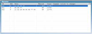

  • Im little closer to complete CAN library... Now sending CAN messages are fixed and work normaly... In loop I send 3 different messages:
    uint8_t tmp_buffer0[4] = {0x11, 0x22, 0x33, 0x44};
    uint8_t tmp_buffer1[3] = {0x55, 0x66, 0x77};
    uint8_t tmp_buffer2[8] = {0x11, 0x22, 0x33, 0x44, 0x55, 0x66, 0x77, 0x88};
    mcp2515_write_canMsg(MCP_TXB0SIDH, 0x300, 0, 0, sizeof(tmp_buffer0), (uint8_t*)&tmp_buffer0);
    nrf_delay_ms(20);
    mcp2515_write_canMsg(MCP_TXB1SIDH, 0x301, 0, 0, sizeof(tmp_buffer1), (uint8_t*)&tmp_buffer1);
    nrf_delay_ms(20);
    mcp2515_write_canMsg(MCP_TXB2SIDH, 0x302, 0, 0, sizeof(tmp_buffer2), (uint8_t*)&tmp_buffer2);
    nrf_delay_ms(20);
    And data is received on end device:
